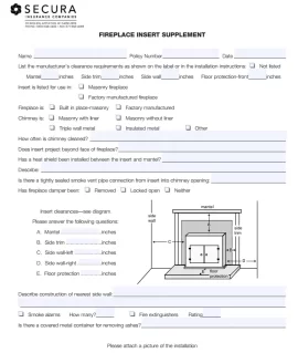

This company does even ask about professional installation. They do ask good questions but by whom it was installed is not one of them.
Below is the application for an insert.

Seems like up here in BC. Insurers are getting more nervous or something. I had to do a inspection this year for a homeowner who had lived in the same place with the same insurer for 27 years. Never had a claim and always had their fireplace on the insurance. Out of the blue, full inspection before re-insured.
So my experience as a sweep has been insurers are all over the map from. Just telling them and they list it, to questionnaires as you posted, to ful, inspection reports. And the trend seems to be moving towards full inspection reports.
As you said a block off plate shouldn't cause a fire unless say the flue collar attachment was compromised while installing, even if not undoing to do it. If a block off plate was being installed how it's common to do it, disconnecting to put in place. Well obviously that could be a concern for an insurance company.
Kind of splitting hairs I know but cya,cya,cya is my mantra with insurance.
