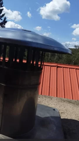

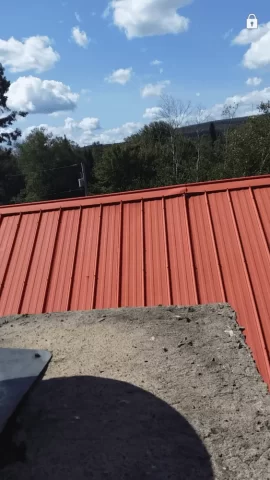

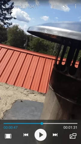

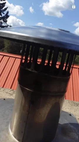

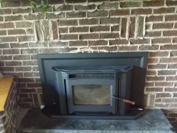

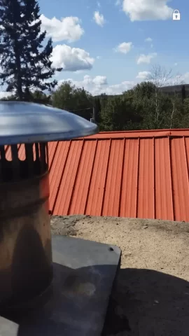

Used to have outside air for the old chimney but I blocked it. The cold air used to be felt in the brick vents but I blocked those too as you can see in the pic. The cold air is now felt from underneath the fireplace.
I had a look at the top. It looks to be carried and looks to be sealed with a metal plate. However looks like the metal plate might have lifted a bit on one side.
[Hearth.com] Block off plate, roxul, code? [Hearth.com] Block off plate, roxul, code? [Hearth.com] Block off plate, roxul, code? [Hearth.com] Block off plate, roxul, code? [Hearth.com] Block off plate, roxul, code?
Its that top cap sealed to the chimney cap on all sides or sort of floating above it? the right side picture seems to have a gap underneath it, but this might just be the picture. If there is a gap, it needs to be sealed with silicone.
This a better pic? Not sure what you mean exactly
Edit: if you mean just the cap by itself, then it must be attached as it would have flown off or be pushed off by snow over the years I imagine.

The top cap is the plate that attaches to the chimney crown and also provides an anchor for the liner. Hard to tell from the picture, it looks like it has an anchor at each corner so it may be ok. If the liner is attached to it then that will stop it from getting pushed off.
