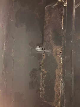

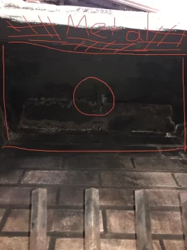

Hello all. I am about to get my first insert. I talked to 4 different dealers in my area and none of them installs a block off plate around the damper area. The only block the chimney on the top. So I decide to make my own plate, following instructions on one of the posts here, using 28 ga steel. My question is do I install right above the firebox like it is shown in the picture below and screw it on the brick and on the metal piece on the front side of the fireplace? The installer said they will remove the damper, I am assuming that they will only remove the door with the handle in the first picture, correct? Thank you!

Yes, it goes below the damper area. The way you have drawn this looks fine. Put some roxul or kaowool insulation above it, around the liner.
yup looks just like mine. I would remove the dampener and either store it or throw it out. Make a block off plate from 316 stainless steel, corrosion resistance and place kaowool as "begreen" mention. I secured the block off plate to the brick with screws.

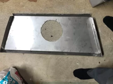

I ended up making this out of 20 ga SS.
Heavy duty and classy. That will last forever.
