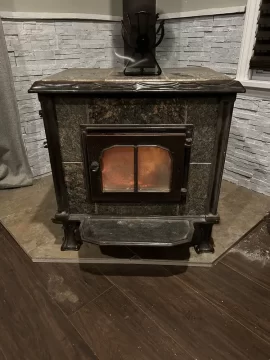

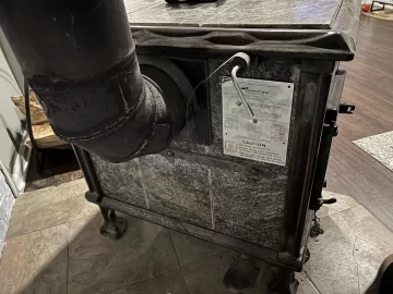

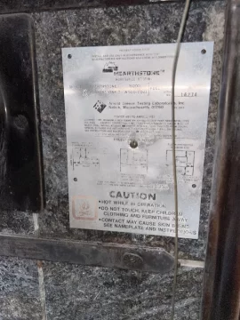

Hi everyone, I bought a house last year that has a hearthstone 2 stove and i have grown to love burning wood. I would really like to install a blower though to help push the heat around. Not sure if it is even possible with how old this model is. Any suggestions would be appreciated.

You may be out of luck. Hearthstone blower kits are designed to be attached to rear mounted heat shields. I don't believe there is a heat shield available for this model...
