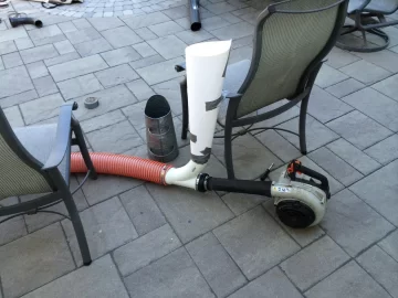

The only place near me that delivers bulk pellets isn't making deliveries until sometime in September. I can load my pellet bin manually but it's a two person process and since I don't have a bulk head I have to lug the pellets through the house and down the stairs.
So I decided to try to use my leaf blower to blow the pellets into the bin using the bulk feed fitting. I mocked up a few pieces of PVC, a large plastic funnel, a couple of fernco fittings and the leaf blower.
Low and behold it worked! The only modification I'm going to make is to attach a toilet fitting to the bottom of a 5 gallon bucket.

I'm blowing the pellets 35' and it's doing it easily. I suspect up to 50' would work as well. I'm pretty impressed with the speed too. It's blowing about 120 pounds a minute based on the video footage.
120#/minute? Sounds like you got it dailed in on the first attempt? Seems pretty damn efficient.
Good reads here- http://forum.iburncorn.com/wiki/index.php/Venturi
It can move the pellets faster than I can load them into the bucket. I have a hopper that holds 550 pounds of pellets. I may try to rig that up so I can fill the hopper with pellets first, turn on the blower and then load the bags directly into the hopper. Hopefully, at that point I could load the hopper faster than it can be emptied.
If I can do that it could cut my time down from 1 ton per hour to maybe 20 - 30 minutes per ton.

I'm using 3" PVC pipe and my set up uses a wye instead of a T. I am able to blow a ton of pellets into the bin in 20 minutes. As long as the pellets are right beside my fill port I can just barely keep up with the blower.
I am blowing the pellets about 50' horizontally into the bin and since I am using a bag bin I don't have an exhaust port so there is a considerable amount of back pressure. I suspect my system could push the pellets up a 7' rise but you might want to put a slide plate at the base to control the feed rate.
My blower is just a $50 Black and Decker with a claimed 250 MPH blowing speed. I'm using the nozzle that came with the blower. It tapers down to a 2 1/2" wide by 1" opening and I place the nozzle just behind where the pellets fall into the wye.

Funny, Inspired by what you had built Andrew, I have been looking at using a leaf blower to load pellets in my silo, and I ordered some fittings and hoses last week.
I did some searching and found this design is quite common for filling deer feeders and their protein looks similar to wood pellets.
There are commercial units which are a bit expensive for the once / twice or maybe three times a year usage.

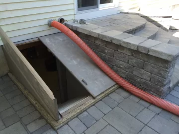

My pipe and fittings arrived the other day. The 4" hose is the same style as used with the Windhager suction hose, clear with reinforcing mesh with an orange spiral with a ground wire embedded in it. I bought a 4" male and female connecter that hooks up to the fittings I have on the outside of my house. A trip to Lowes for some fittings and I hooked up my leaf blower with a simple paper funnel to check it worked. It was pretty fast, the small fines tended to blow out of the funnel a bit but the pellets shot into the silo quite far. Not so far as when the pellet bulk truck shot them in, so I might not get in as much as before. I will butcher an old trash plastic barrel at one point and do a setup similar to one of the links I posted. Easier than I thought.

Not sure exactly how I will set it up, maybe outside my garage rear door, minimize the foot travel.
Maybe a shop vac on the exhaust port, depends on dust etc. It was dusty when I had the bulk delivery.
I bought the hose and fittings for the silo itself from Vermont Renewable Fuels. The male on the house is the inlet and female the outlet.
