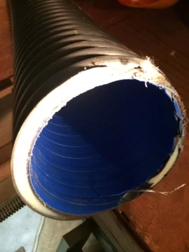

Thanks. What's interesting is that Maine Energy Systems sold me a very heavy duty (abrasion resistant?) 4" what looks like rubber pipe, but the reinforcing cord is plastic and not metal, so I don't know if it maybe intrinsically is anti-static or something. I sent them and email, and maybe will talk with them tomorrow about it.
The fill and exhaust pipe I got from Vermont Renewable Fuels was also the black heavy duty rubber hose with a rib around it.
Have you cut your hose yet? I am sure it is the same, carefully cut into it and you will find them.
Inside the rib in mine were some multi-strand wires, not thick but sufficient for static purposes.
You cut the hose slightly longer and wrap the wire inside so it touches the fittings before you clamp it up.

I did a couple of biopsies, and man, is that hard to cut. I used a Dremel, among other things-nothing satisfactory for a snippet. What in the world did you cut it with? I'm thinking maybe a chop saw?
I found no wire though.
Then, I had the bright idea of looking for markings on the pipe, and it was tigerflex uf-1 400.
http://www.plastixs.com/tiger_ureflex1.html
"Black HMW PVC convoluted cover formulated with static-dissipative compound"
The kit I got from Vermont had a male and female, the male they use for the bulk filling. Sandri also connected a pipe to the female fitting to direct the dust away from the house. If you are getting bulk fill and your supplier is ok with the 2 female fitting then you are good to go.
I think I cut mine with a hacksaw. Wrapped masking tape round it first and made a line so I cut it straight.
See my post above. It's in the compound. Please tell me how you cut the darn thing-it's way tough.

Here is a picture of my black hose with the wire embedded, not the best picture.
You hose seems to be the latest design?
I cut the hose so the wire was long, made sure it was inside the fitting it connects to and then wrapped it around the hose clamp.
I also used some multi-strand wire to connect the clamp to the silo. I then grounded the silo to my house electrical ground which connects to 2 ground spikes.
