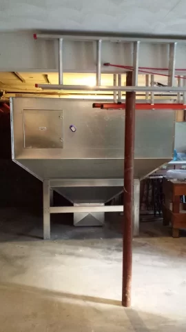

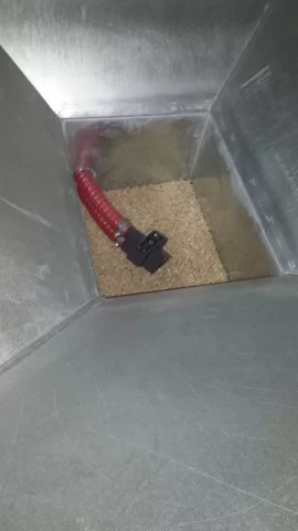

The forth picture is a 4 ton bulk storage. I get about 100 days out of that. The way it looks I will to fill the bulk storage twice a year.
Wow, you could take a month long vaca in January and not have to have a frozen house or someone coming to take care of it. That is awesome.

If there was 3-4 tons of pellets in the bulk storage and I just emptied the ashes before I left. It could easily do a month without being worried about it.

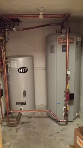

Markus, very nice! I have a BioWin 100/150 on order and might copy your system! How large is your heat buffer and how is it working? How about the indirect? To echo Dana, how are you heating DHW in the summer? know the recommendation is that you don't need a buffer tank, but I would still like to use my wood insert, and I think a well insulated heat store tank like you have might do the trick.

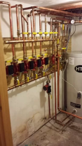

Also, can you tell me something about what looks like circulator pumps?

The thermal store is a 120 gallon Turbomax 109 made by Thermo2000. It works well. It gives instant heat when the zones ask for it rather than waiting for the pellets boiler to fire. At first I was not going to get the store but the MA grant required it. They also calculated the capacity of at least 10 gallons/10,000 Btu/hr (or as space allowed). That may be a bit more than I need but I can only complain about its cost ($3800).
The circulators are the modern (they push rather than pull the water like my old ones did) tjey are three speed 1/25 hp. Pex supply sells them http://www.pexsupply.com/Grundfos-59896343-UPS15-58FRC-3-Speed-Rotated-Flanged-Circulator-Pump-1-25-HP-115-volt-4702000-p

Yes, my current circulators pull down to the oil boiler return. It looks like it'll get a complete makeover.
