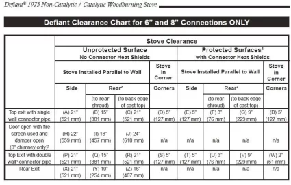

It varies from stove to stove. Some companies test and list the reduced clearances. Some say that clearance can be reduced with an approved wall shield, but don't list the reduction. And other companies say nothing about clearance reduction. We've had folks insist that this only applies to the 36" rule, but take a look at the Defiant 2n1 docs where they have a dramatic clearance reduction (under 12") using a wall shield and even show in detail how to build one. Confusing, eh?
