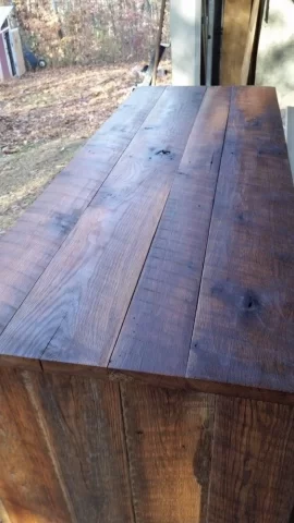

Here is a pic of the top. 3 coats of the poly/oil.
  • [Hearth.com] Boiled Linseed Oil as a Finish??
That is about the look I am going for. I have been doing some reading, and found lots of good information about doing the mineral spirits, BLO and oil based clear finish combination.
Do you sand down the finish at all between coats?
000 steelwool between coats. you made need more than 3 coat depending on how thirsty the wood is. that pic doesn't do the finish justice imo. try it on a scrap piece and see what you think.

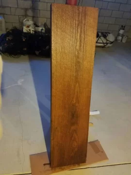

This just needs a couple coats of an oil based varnish/mineral spirits mixture yet. Two coats of BLO applied that really brought the life back to a weathered plank of oak.
