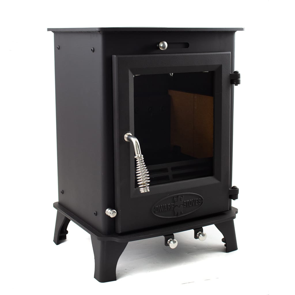

The ideal thing for what your described would a freestanding wood stove inside. You can find some very small units (or make your own) that take just a small footprint. Using the proper material on the walls will get you almost zero clearance. Before going with a boiler in my shop to heat the home too, I used a stove in the shop. Doesn't take much of a fire to take the chill out. Here is a link as an idea, I wouldn't buy but make my own. Maybe I would spend $400 on something similar. Or maybe a pellet stove.
