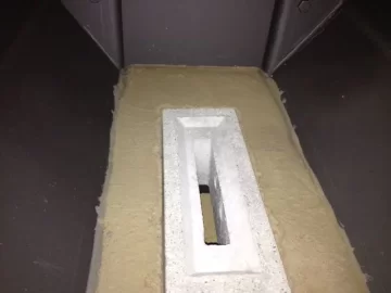

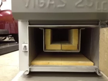

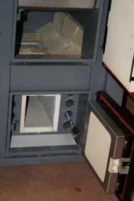

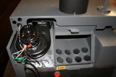

I have have been operating a high efficiency boiler for about 30 years A boiler that has a lot of refractory but that is fairly easy to maintain and the nozzle is easy to make and change.
The refractory component of these boilers can be expensive to maintain. The nozzle where the secondary combustion takes place can see a lot of wear.
One aspect I would be looking at as part of the criteria for purchasing a boiler, would be the degree of difficulty involved in maintaining the refractory and if the nozzle can changed.
Below are examples of two such boilers. The first one is the Empyre Elite 100 that has a simple system of fire brick in both chambers. The second one is a Vigas with a changeable nozzle in the primary burn chamber and a simple arrangement of fire brick in the secondary burn chamber.

One aspect I would be looking at as part of the criteria for purchasing a boiler, would be the degree of difficulty involved in maintaining the refractory and if the nozzle can changed. Below are examples of two such boilers. The first one is the Empyre Elite 100 that has a simple system of fire brick in both chambers. The second one is a Vigas with a changeable nozzle in the primary burn chamber and a simple arrangement of fire brick in the secondary burn chamber.
