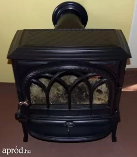

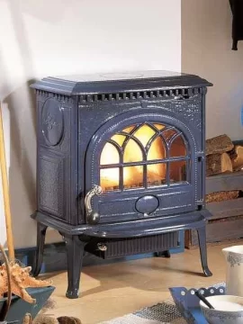

The F100 has a deep cast waffle ribbing that appears to act as a trivet. This is different from the light cross-hatch pattern on the top of the F400 or F3CB. You can boil water on these stoves.

Do you think the deep waffle form is making a difference? I haven't lit the stove yet this year, but will record the top temperature when I do. My suspicion is that the pattern is just preventing a lot of direct heat transfer.
I suspect the top is acting as a trivet. How deep is it to the actual stove top, between the waffle grates?
That's a large enough gap to allow air to circulate under what is placed on the stove top and cool down the temp. Good for steamers and bun warmers, not good for boiling a kettle.
