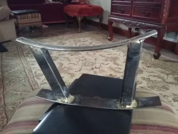

I was bored today so I decided to build a rear "stop" for the log shelf on my log splitter. I hacked up some used steel I had and brazed it together. I was using a new, auto darkening helmet and had it set to 9-15 and really couldn't see what I was doing. It's not pretty but it will prevent any log from hitting my engine and it won't fall apart! My miters were pretty primitive, but it's strong enough.

What did you braze them together with? Oxy-acetylene torch? Oxy-acetylene should be around a shade 5.
Arc welding requires shades 9 to 15 depending on process and amperage.

Yeah, oxy acetylene, and I know, but I wasn't sure how to change the setting on the helmet. I know now though. There is a switch! (for reference, I spent 40 years with an oxy/propane torch in my hand, personally, I hate acetylene. But my other torches are too small for 3/8" steel. Arc was too much trouble.
I was going to re-fillet it tomorrow but it is good enough, so it has the first coat of paint on it now, drying by the wood burner.

Now I'm curious what you did that you used the oxy-propane torch for? I've worked in a fab shop for the last 10 years, only thing we use oxy-acetylene for is cutting, and that is now mostly replaced with plasma. Everything we make is welded, stick or flux-core. Never had much experience with brazing other than a handful of times in school.

By trade, I am a jeweler/goldsmith. I am unused to putting a torch to something this big. Acetylene is too dirty for my real work, and actually, it cannot be used with platinum, too much carbon, it contaminates the metal.
