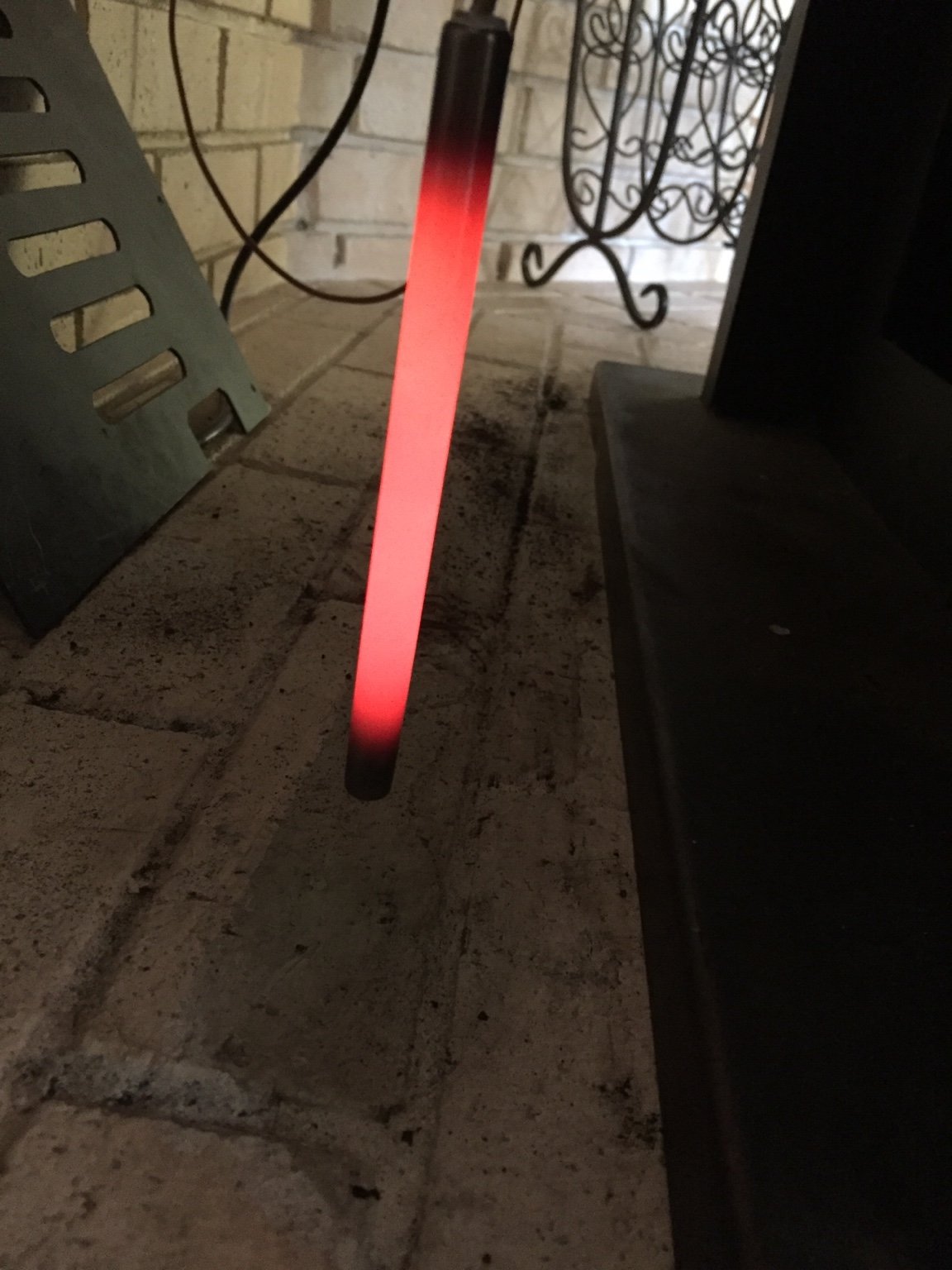

I pulled the igniter out to make sure the whole thing is getting hot. Just the tip is not red hot. Is this normal?
[Hearth.com] Bosca Soul Won't Ignite
I think that's okay. Something is preventing the hot air from around the ignitor from reaching the pellets, i.e. an airflow problem. It's the hot air that actually ignites the pellets. Make sure you have a good draft, and a clear passage from the ignitor to the burn pot.
