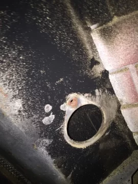

The photo of the cartridge heater glowing red hot looks normal. The tip won't run as hot as the rest of it.

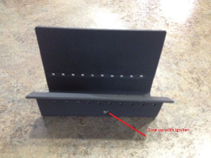

I have a Bosca as well. Like the above post indicates, make sure that the burn pot liner is installed correctly into the burn pot.
The photos below depict correct orientation. Also, the tip of the igniter should not be flush with the end of the tube it is installed in. It should be set back inside the tube about 0.125"

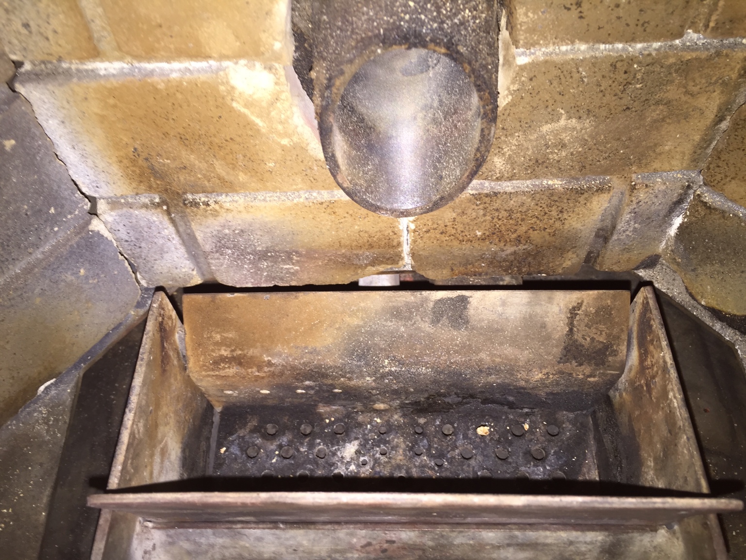

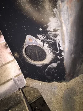

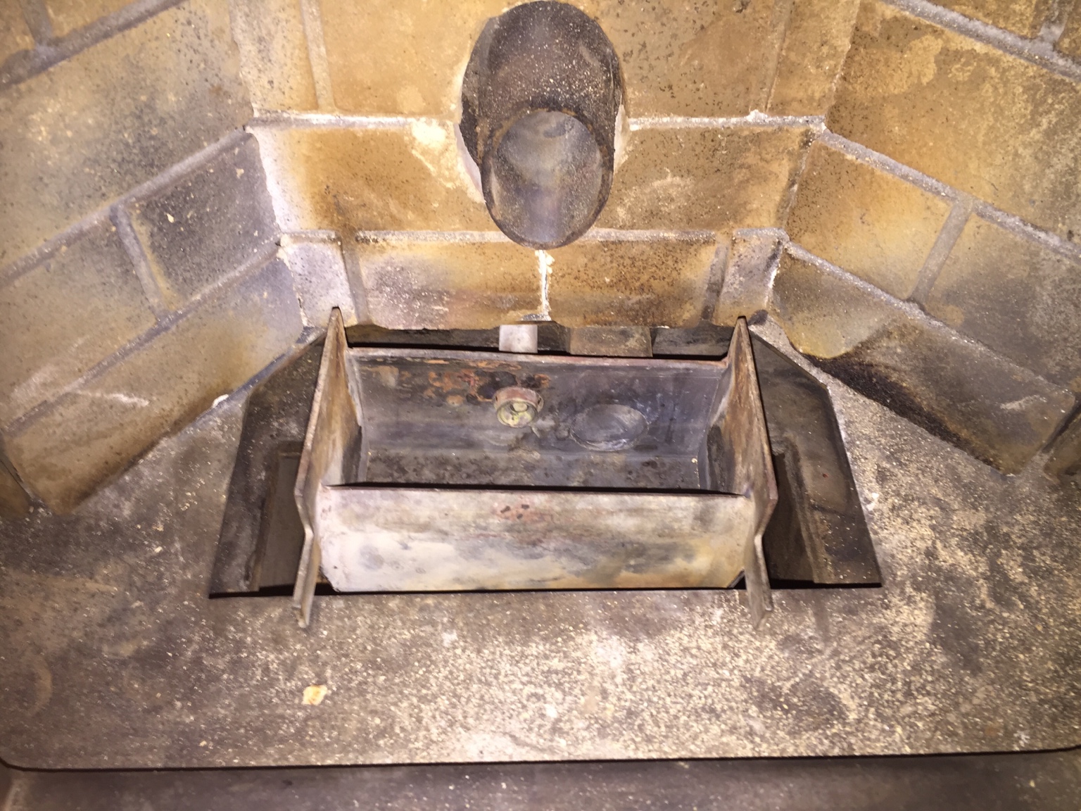

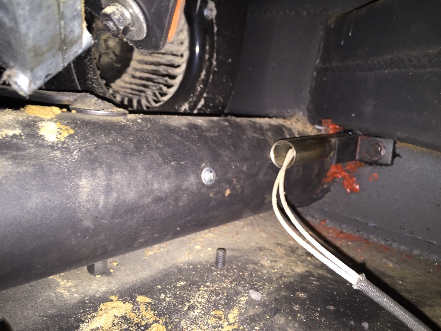

Those of you with the Bosca's, what does the igniter tube look like in the back? Mine is completely open. Also, the tube has no holes other than the open ends. I'm wondering if I'm missing something.
[Hearth.com] Bosca Soul Won't Ignite
You do have the igniter centered in the tube and secured with the 2 set screws, right?
Your setup looks fine
It is open in the back just like mine.
Not sure what else it could be.

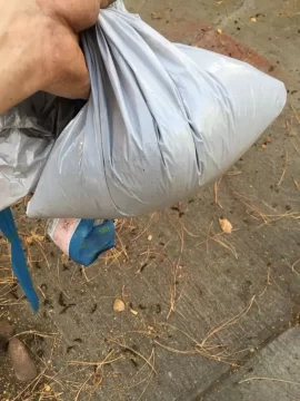

I swept the flue, and got about 2 cups worth of soot.
