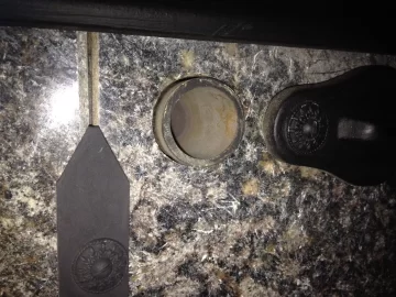

Should I go so far as filling in the gap around the secondary air tube where it comes through the stone. There is a decent sized gap that leaks as well.

i would plug the secondary pipe gap. i've plugged the gap with pieces of door gasket but it keeps getting pushed out with the heating and cooling of the stove. i'm going to try small glass gasketing that is flat. i've used this on my defiant and it worked great.

He said plug gap in the connection of the secondary tube to the manifold. Not the tube itself.
Reactions: Andrew V
Meaning where the secondary goes through & between the stone and the outside of the tube? Ok, that makes sense....10-4
yes around the tube between the outside of the tube and the stone. that stone is a inch and a quarter thick so push it in.
Also check the opposite end of the 2ndary tube, the end by the load door. it's supposed to be plugged at that end with cement. If the cement weren't there, it'd be like having a big hole in the stove. THAT would suck air!
