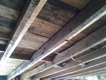

The house is a 1900 house. When I moved in there was carpet in the upper room. Which I ripped out. All that was/is under that is T&G boards. All of them appear to be still attached to the joist.
The first pic is when you walk into the room.

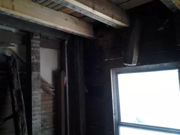

Second pic is the area ( middle) where it is bouncy

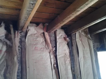

Third pic is showing they fastened the joist ( if you can see it)

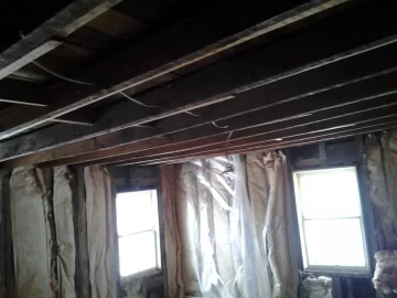

Fourth pic is a corner / window I have no idea what to do with.
As you can see someone put up newer joists next to the old ones.

OK, yeah we can see its been sistered already, but no obvious big notches in the joists. So, Im guessing the problem is the joists are undersized for the span spacing or some supporting wall was removed.
The one thing I can quite tell from that third image is how the joists are attached. In balloon framing the studs run from the mudsill all the way to the top plate in the attic, and the second floor joists would be nailed to the sides of the studs, and should also be supported on a ledger band that is notched into the studs. Platform framing is modern construction where the second floor joists sit on top of the plate for the first floor.
Either way I have to punt at this point at being beyond my depth to advise on the best course of action.

2x8 joists with 24" spacing on what looks like a 12-14' span? That would definately flex a bit.
Couple things I see:
1. Only partial height blocking, not that full height blocking helps all that much but partial height blocking doesn't really do anything at all.
2. Looks like someone used two new pieces of lumber to sister each joist as I see joints in the middle. It should be one piece end to end otherwise it doesn't do much (or use a very liberal amount of glue and fasteners, probably cheaper to just buy a longer joist)
Either properly sister the joists, go one or two sizes up in the joists, or put a beam in. FYI, a beam to hold a floor mid-span over a 12-14' unsupported length is pretty large.

Please reread what I wrote; I was not talking about sistering at that point. At any rate , it's about a bouncy floor, and now that I've seen the pics., I think first responder lukem had it right. Add joists to make 12" spacing
Reactions: lukem
At that span I'd add the joists to make it 12 OC. Sistering won't help a ton as you seen because a lot of the bounce may be coming from the deflection of the subfloor...not the structure. When understructured add wood where there isnt...not more where there is. Might even consider going next size up on new joists and fur out the difference on existing.
Adding a beam would,as others have said, would increase point loads where the structure underneath may not be able to support it. I don't think you want to go there.
