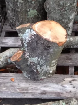

What do yall do with pieces like these? Just burn them whole? Toss them?

I put the lower part in the splitter facing the wedge and hope it will split. If it doesn't, I toss it into the brush dump or wait 3+ yrs for it to dry.

Turn it upside down and whack it. That's what I do. If it's a smaller crotch 8-10" usually no probs, but bigger rounds/knots are tougher. I split all my wood by hand and several crotches like these.

I try, and often succeed, by splitting at an angle that splits not only the main part of the round but the next bigger side branch all in one pass. In your pic I would align my Fiskars to strike as if I was going after that branch on the top left but to also hit in the middle of the round itself. I hope this makes sense since it is hard for me to describe what I mean.
What ends up happening is the round and the knot formed by that side branch split all at once. After that, if I need a smaller split, I just split away the main round to half of what is left.

Noodling is using the chainsaw to cut with the grain instead of against the grain like normal. Instead of making wood chips the saw makes wood "noodles". It's a way to get knotty pieces into manageable sizes without whacking at it a ton of times.

Get you saw out and cut the branches off to make a split and stack it. Then get a wedge and split it that way . If it don't want to split turn it upside down and split it that way. Then if It don't split then it goes into a pile to be noodled. I haven't found anything that will not split or noodled as of yet. Get a crouch turn upside down splits just about every time. I also split everything by hand.
What I do with pieces like that is lay it down on the ground and cut down the center of it CAREFULLY. "Noodling" a smaller piece like that is one of the more dangerous things you can do with a chainsaw.
I normally cut about half way through, and make a deeper cut on the top (make sure you're not sawing into the ground!). Then I put the piece on my splitting block and give it a wack. If it doesn't split that way, lay it down on the splitting block and give it a wack. Those knotty pieces are a PITA but they do burn good.

Not sure what kind of axe you're using. Before I got my 27 ton, this is what I would do with ugly pieces like that:
Use an axe that has one flat side like a sledgehammer. Then, swing at log like normal, hoping to split it but knowing it probably not gonna happen.
With axe stuck in wood, swing the whole thing around over top of your dominant shoulder and bring down on your block as hard as you can on the flat side of axe.
Just make sure the axe is stuck real good in wood and axe head pretty secure to the handle or you'll get a hell of a heacache.
I think I could split that, and I'd do it the way Oldman describes. I'd split either from top or bottom, depending which way the round will stand on end. I'd strike at an angle so that the plane along which I am splitting would pass through the two larger branches. This will yield two Y shaped splits. If it had only two branches I am sure it would split. The third, smaller branch might cause a problem. Give it a try and see. Most two-branch Ys split pretty easily, but the more complex crotches can sometimes be so hard to split it isn't worth it.

I split by hand. For something like that I have a couple of cone shaped splitting wedges with a pointy end and a 10lb maul. Usually can at least get the larger trunk piece to split in half. Noodling is also an option.

To add to this, with any tough piece, i just sink my maul as deep as possible with one swing, then I have a small 4 lb sledge hammer that I'll smack the blunt end of the mail with while its stuck in the wood. This almost always splits thru, even if you have to peel it apart a bit.
Also when I come to this part of a tree while cutting, I try to cut it straight as possible with the chainsaw, even if I have to cut the piece shorter or longer than usual. Good luck with the knotty stuff!

Another option is to think ahead while cutting, and cut inline with the log, and let the branched pieces have an ugly end. I'd rather spend an extra 15 seconds on a saw than a minute on an axe. I'm lazy like that. Something about handlebars sticking out like that makes them real hard to split.

Noodling will work. ( can't see how it hurts saw)
or depending on the dimensions make another bucking cut so that either piece will fit in the stove door.
