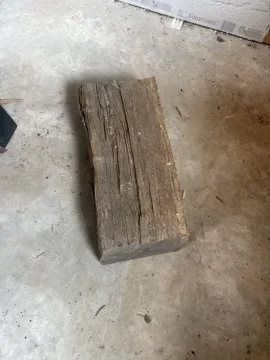

I bought a large amount of cut oak last spring. Lately I’ve noticed some pieces burn decent while other pieces burn crazy hot. I had 1 piece take my small wood burner over 900 degrees(it maxed out my gauge). Even warped my door slightly . I’ve noticed the extra hot wood is very square. No bark. I’m wondering if it’s some very old wood maybe from barn beams? Something is different about them. They are slightly heavier . 1 piece of this super wood can burn hotter than filling my stove with the normal oak

Looks like it could be a barn beam indeed - from the color.

Can you resplit the piece and take a pic on the insides?

Maybe the beam was treated with some oil in the past
