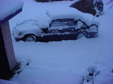

I love snow as long as I don't have to drive in it. Believe it or not, we actually had a big snow a few years ago here, the day before Thanksgiving.
When I woke up I thought I was living in Big Bear!
  • [Hearth.com] Break-In Fire Question

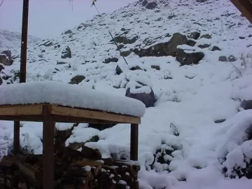

Nice snowfall,
That's a fall teaser here. But at least you guys had the wood covered.(Not that it wouldn't dry within the next day)
