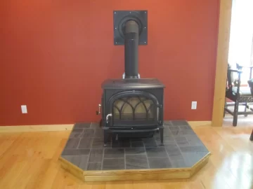

Thanks everyone for the info. I did the three burns, following the manual and am now sitting in a toasty living room while it is 40 degrees outside tonight. BTW - I got very little gas odor with the Oslo's Blue/Black enamel.
Glad it went well. Post a pic of that beauty. Kitchen is your avatar a picture of your land?

The blue/black finish is gorgeous! :cool:

[Hearth.com] Breaking in an Oslo
Great looking stove! Fantastic view, as well. Thanks for sharing.
40F at the end of May, what wacky weather we have. As you've noticed, the enameled Jotuls don't emit a lot of smell when breaking in. That smell is mostly with painted stoves. The paint outgases as it bakes in.
You're going to love the blue-black enamel. It keeps looking sharp year after year with just a quick towel wipe. Enjoy the new stove! It's a beauty.

I can't quite see the stove top meter but I'm thinking you could probably run a bit hotter than that. ;)
