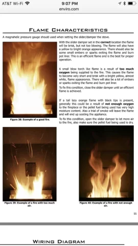

here is a good reference
  • [Hearth.com] Breckwell big E issues
