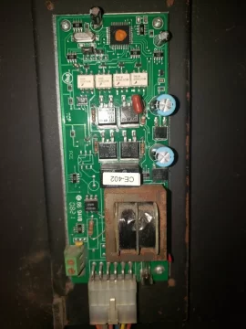

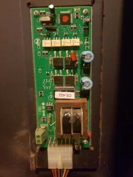

Does this curicut board look fried. I see a weird guy that looks not shiny. Upper left quadrant.

i would say the dampness took out the board their is a lot of rust on that unit.. Hydro surge may have taken it the rest of the way out.. I have the same stove and they can take allot of punishment i had a faulty battery backup that was sending power surges through my stove for a year and its still working..

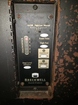

Sounds like Proof of Fire switch or Vacuum Switch do you get any blinking lights on your control panel blinking 3 is Proof of Fire and Blinking 2 is Vacuum Switch. The click you hear is probably one or the other. Then the stove goes into shut down bumping pellets into burn pot every 10 seconds until it goes out. If you are getting blinking light then you can try to jump the corresponding switch. Unplug stove, unplug problem switch and connect the two wires with a jumper or paper clip, put tape on the wire connections to make sure they do not ground out on stove and try to start stove.

Okay I'll check to see which number flashes. But off top of my head I dont think any number flashes. Yes it is damp down there at time during excessive rainfall in winter. Thatd be a bummer if board was shot. Any idea where tobget a new one thats not 300$,?

Usually can get them repaired for around $175, but I would try jumping both those switches one at a time before spending the money even if no lights are blinking. Does it take less then 10 minutes for the click that is how long the stove looks for Proof of Fire before it goes into auto shutdown.

. If I change to level 1,2,3,4 or 5 .. its still that slow 10 second time till the auger engages
Heat level can not be adjusted during stove start up, From operators manual:
The Heat Level Advance is inoperable during the ignition start period. When the green light
continuously stays on the Heat Level Advance can be adjusted to achieve the desired heat output

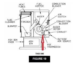

Okay. So as soon as I touched the POF Thermodisk the plastic ends that cover the metal connectors of the wires disintegrated . I wiggled them connector ends a little. Everything seems very rusty looking.
But after that jiggle or whatever. Thr heat level advanced is working now . The level five feeds like it should be.
I am ordering new wires and a new pof due to the rust. Thank you all. I truly appreciate thr suggestions and wish you all the very best. hopefully one more season outta this bad girl :)

I think I saw #3 blinking.
