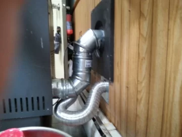

My exhaust has 2 90° elbows the straight through the thimble to a t with a clean out then 6' straight up with a cap. I have the outside air kit installed also. It was working great for a month. Then I brushed and vacuumed it all out and now it does this.

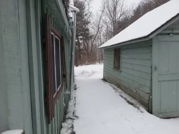

Here is my exhaust set up.
  • [Hearth.com] breckwell model p2700fsa
