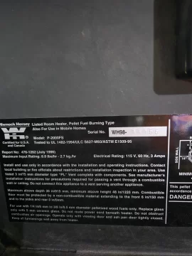

Their are 2 different motors for your unit depending on the control panel and date of manufacturer. If it is not feeding enough i would bet you got the wrong motor, what was the RPM on the original.

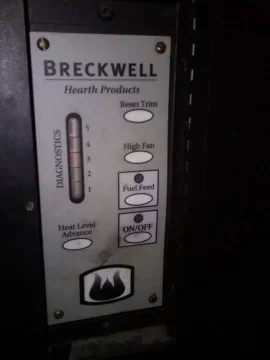

The above is only for setting the heat setting #1 ( basically the keep alive flame) so it does not go out on you when you put it down to 1. Of your having issues identifying what motor you need post up a picture of the control panel and the date stamp of the stove. When you get this stove running properly they are a great stove. I have a older unit that i got used and it has been rock solid. I have replaced all the motors and control board due to a motor sizing up and sending a power surge though the unit but that was my fault as the motor that caused this was installed upside down so i did not see the oil port on it and never oiled it. But after replacing everything the unit has never run better

1996 unit. Serial number 11155. Ive done the trim adjustment and it still won't feed the burnpot for startup. It has the digital board.
