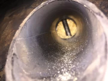

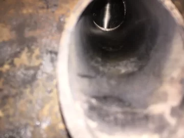

This happened to me. i emptied the pellets and saw that the auger was not moving at all.
borrowed from the 'mirror trick' mentioned here but used my phone to snap pictures through the chute (see attached)
used a screw driver to loosen it up, then stuck the vacuum there while i turned the auger on the help with the pressure to get it out.
