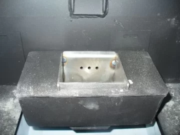

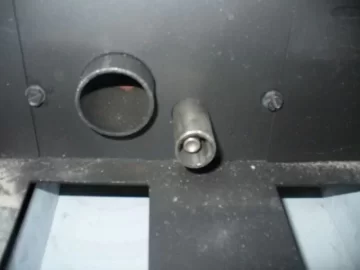

As for the burn put is this what you mean. It just pulls out.
Yes you should have the carraige bolts in place that are in the burn pot. As for the insulation it does come with the unit and we use it on the top of the hopper to keep condensation down.

You should be able to use a small prybar or flat bar to removed the burn pot. You have to get inside that large black burn pot to get the ash out or it will cause a bad burn due to the restricted air flow.

Since I had the stove off yesterday due to the unseasonable outside warmth, I did as you suggested and pried the box loose.
There were some good size metal burrs around the edges of the large pipe/hole which I filed down, but the issue appears to have been that the leveling screw under that box was out so far that the box would jam up against the inlet pipe and the ignitor tube before it could get all the way in. It was definitely not all the way in before as now I have much better flame control. I actually had to push the damper in a bit to get back to good flame.
