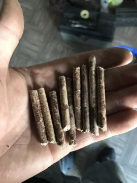

Do your pellets look something like this? Pellet length plays an important role in how your auger feeds. A few long pellets can cause a pin to snap if conditions are just right. I’d pull the auger or auger cover depending on the stove and make sure there are no foreign objects in there but I’d also make sure your burning a pellet that is consistently 1” or less in length. The right fuel makes a world of difference.

I have pulled the auger motor a lot, one reason why i hate this stove, i have been using the same brand of pellets but have noticed the current batch seems a bit longer than they used to, not as long as those in the picture though, i checked the tube and it is smooth, i filed down the edges on the auger just in case it was somehow catching on an imperfection in the tube i can't see, i ended up drilling it out and putting in a larger solid pin, so far it is working, also is it common for the auger motor case screws to come loose? The old motor and now this new one have done it, about to put some red locktite on them dang things
