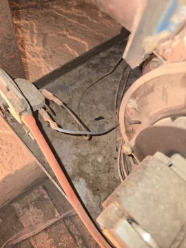

I did jump the black/ blue terminals of the vacuum sensor but it didn't cause motor to run. Black comes from auger motor to vacuum sensor & blue goes from vacuum sensor to load terminal of timer module

Yes all items u mention are good. Only black/ blue wires to vacuum switch. Never had 2 blues

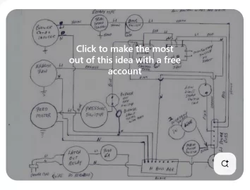

If you have a background in this sort of thing you should draw a schematic from the wiring diagram.
Here is a post I found as an example
