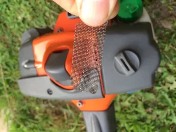

Removed spark arrestor , it's clean and nice . Runs same way . Checked the spark plug : perfect . Don't know what else to check . Called customer care , they said "go to dealer , sounds like you need carburetor adjustment "

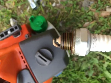

Hm, actually when I looked at my posted pictures I can see some black deposits on a tip of spark plug , wondering if it can cause trimmer RPM to fluctuate and stall when pushed to the max. I don't think so , but ,again, not much of experience here

I'd change that plug. Parts Tree says replacement is Champion RCJ6Y. Most all small 2 cycles gap at .020" - .025".
