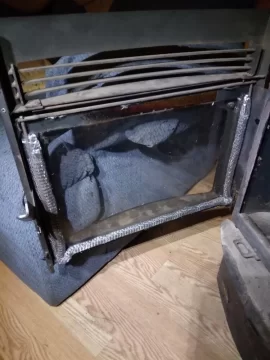

Well with some guidance of a member that was nice enough to take the time, Ive learned that the stove only runs with the vac switch bypassed or jumped as u say. We bought a new vac switch btw and that didnt fix it so..... We thought we had a vacumm leak as we have never changed our door gasket, Pictured here is our new gasket installed. Sadly it didnt help....still the same thing. Only starts up when vac switch has been jumped. We have checked the vaccum line and ports and like mentioned added new vac switch.
Any one know of where else there could be a vac issue. Yes we have cleaned the stove two weekends ago i removed it from the exhaust pipe and throughly cleaned everything....removed all the panels sides and rear, and all bricks. Some folks have mentioned about some gasket under the burn pot, but our manual shows no such thing. Ive even googled our model and cant find any piks of a gasket under the pot. Our stove is older model so that must be a newer thing i suppose. Same as the air wash location. Ours is up top not on the bottom.

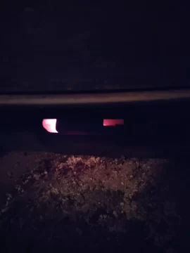

Its still not firing up as fast as it has in the past. Still need to hit the reset button a few times to get it going but it did start all on its own this morning...Flame looks good too. Hopefully when I get home this evening its still going. Luckily its warmed up around here. I took of pik of the igniter so if anyone has any opinions of what is looks like or should look like feel free to express your opinion To me it looks like it always has.
