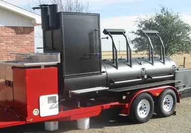

While I'm new to wood stoves, I have some experience with fireboxes! I'll see if I can figure out how to post a pic to show you what I mean.
  • [Hearth.com] Buck 91 for new home, Advice?
Ah yes. The standard Plainview backyard barbeque. By the way, there is a guy that sells Pacific Energy stoves on eBay at good prices and he is in Hereford. He isn't listed by PE as a legit dealer but sure does sell'em for a right price with freight included. So if he would back out the freight cost you might get a great deal on a good stove from him.
