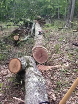

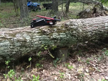

Well what's big for me may not be for you, but ......This is about a 2' oak out in the woods in back of my cabin. At that size I need to do things a bit different. First I need to keep the tree trunk in the air. My secret tool is a 2 ton floor jack. It can get into a 3 inch space. Amazing what it can lift. Next issue is 18" bar can't cut clear across. So I alternate from side to side. This can be a bit hard to keep the cut straight. My method, alternate a lot. Then moving the rounds. Just about imposable to get this size rounds into my new woods trailer. I have a 2' ball on the ATV and tow the splitter to the tree.
Lift the tree, cut a few rounds, split a few, load the splits in the trailer, ride slow back to the house, stack, 10 minute break , repeat for the next few days.
That's what I do, do you have any work saver methods?
Here's a few pictures

Seem to have a good plan! Keep up the hard work and soon you will have a good stack of great BTUs
That is a whoppin' big tree. I think your method is downright innovative. Up till now, I would through-cut an 18 incher from the middle and roll it away. Then through-cut every 6 feet and cut those about 2/3 down every 18 inches, roll it over and finish the partial cuts.

Thanks for the feedback, you guys are the real deal, hard core. Scotty, The jack works great. On top a flat rock or 6' round. I always wanted to use wedges just never had any. I'm always working around not having them. Anyone know if the big box stores have them, tractor supply, etc.?

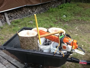

Before towing the splitter out in the woods, I hit the fresh wet 2' rock oak with a maul. To my surprise it bounced off of the wood that splits easy after drying a few months. This was the first time I split in the woods. Wow it was a big work saver with this size rounds. They had to be split, so why deal with moving 150 pound rounds. The rounds in the trailer is the small stuff.
Checkout my helpers

Checkout my helpers
Nice helpers !
Smart to get the heavy rounds down to a manageable size, will help keep the back healthy ;)
