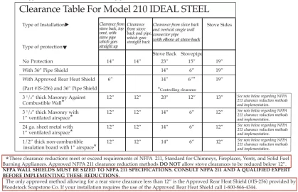

The kind folks at Woodstock just sent me the IS manual. Great, quick customer service! Here is the clearance table. Click to enlarge.

So I should invest in the rear heat shield option.
Yes. Looks like that is your best solution to get the lowest clearance to combustible.
Would that work with double wall stove pipe?
Yes, it should.
I looked at my bill. The rear heat shield comes with it. That must be part of "the works" package.
So if I understand this correctly, I don't even need a hearth. All I would need is half inch drywall, the rear shield, and double wall stove pipe to get my 6" rear clearance.

Call and ask Woodstock. For some reason their manual does not cover double-wall stove pipe. Seems like an oversight, but perhaps they have their reasons.
From the manual:
Clearances can be reduced by attaching an approved heat shield, part #IS-256 and pipe shield, part #W-413.
To further reduce the rear clearance to 6”, you must attach an approved rear heat shield and a 36” pipe shield.
