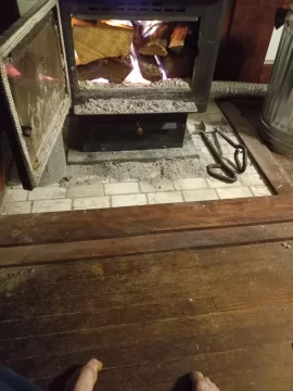

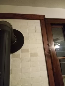

Op. I did mine exactly how your thinking of doing yours. Cement board straight over wood floor then tiled over that and trimmed out with 1x4 and 1x6s. For wall I removed plaster. Cement boards attached to studs then tiled and trimmed

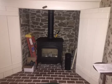

If looking for some real nice brick tiles, check out Inglenook Tile. We got ours there, looking for something that would look appropriately "old" for one of our 18th century fireplaces.
