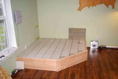

I just started on it yesterday and have the base complete. Any tips for the rest of the job?

Leadfoot,
Looks great for a base.
I way overbuilt mine when I did it. 2 layers of plywood, separated with 1" wide "c" channel a layer of durock, finish layer of pave stones on sides.
All my manufacturer specified was a "non-combustible base" with the proper clearance to combustibles.
If I read it correctly......a sheet of aluminum would have sufficed as an under stove pad.
So as long as you follow or exceed your stove manufacturers minimums you can make it any way you want.
That is if your inspector agrees. Mine was cool with the stove manufacturer directions.
I went way overboard -:)
The brick veneer should look great.

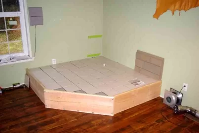

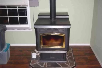

Thanks nailed_nailer, at this time we have a stove mat under it. I just wanted it to look nice. I have brick paneling (I'll have more that the recommended clearance)in the corner where the stove is going. In this area (rural Oklahoma) we don't have building inspectors for things like this that I know of. With the durock and tile I'm sure I'll be fine. I'm also going up about 4' with my pipe then out. I think it will look better and maybe collect a little more heat inside. I have all the correct materials, just need to finish.
This is only my second year using a pellet stove so I wasn't sure just how permaent it was going to be. My wife loves it so it looks like its going to stay...
I wouldn't worry about more nails, but if you don't put a pound of screws into that cement board you didn't do enough. More nails will just make it harder to put all the necessary screws in.
Looks great so far!

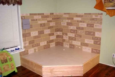

The durock should be glued. They make a glue for it durock is kind of concrete if you notice when you cut it how it crumbles ? When you nail or screw it you break the surface of the durock and the hole will be full of crumbled rock then it is not holding like it should

More pictures with progress(more beer too!) :)
Looks good. You need to tile the front face first then the top, so that the top layer covers the edge of the front face. Post pics when you finish, good luck.
I'm very apprehensive about doing the tile because I've never done it before. I'd hate to make a mess of it so I may hire a tile setter. Whichever way it goes I'll post some images.
I just finished my pad, but I included a nice border-I only did the plywood base and then tile on top. I put the border around so I could line my tiles up to it flush. Good luck. :)

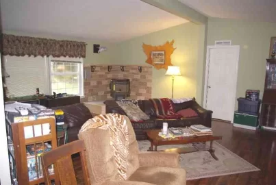

Here is a Piccy of our raised hearth. I had all the tile done except the 3 fronts that needed to be cut.
Once the cement is hard, grout all the joints and allow that to harden for a month, then paint the grount lines with Urethane to keep the dirt from sticking in the grout.
Here are some other pic of the project as it came along.
There is one pix of the Old WP50 and what the corner looked like before I started

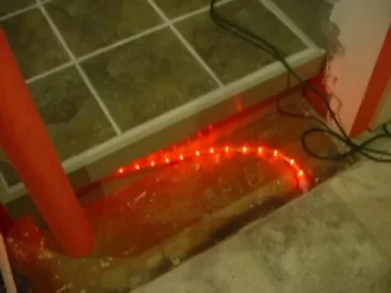

Hello
A little Rope Light would look nice?

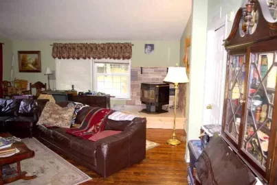

Wow, those are nice. Can't wait to get finished :)
