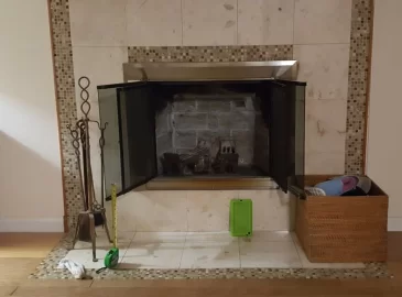

Moved into a new house the fireplace opening is 12" higher then floor. I will have to build a rised hearth.
How do I do this?. The rep said the eazy way would be frame out a box the size I need ( like how you would do a concrete step) put soild cinder bock in it and fill with concrete,then tile it. Does this make sense? My wife would not be please if she came home and there was a 4x2x1 block in her living room that I could not tile.
Putting a liner in is it hard to do 1 story house low pitch roof? Is the Osborn 1800 good.
For the Osburn 1800, if your current hearth is at least 4" above the floor (you're at 12"), then all you need is non-combustible material for the hearth extension, meaning you could skip the concrete block and just put tile (or whatever non-combustible) down instead of what the floor is now.
The current hearth is marble tile that is part of the floor. So it is not rised at tall. The fireplace opening is 12" above the marble tile.

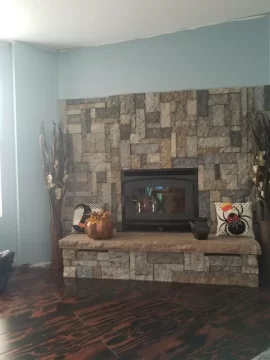

I had the same problem when installing my pacific energy FP30 fireplace it was high off the floor, but I went with the clearance specs required for the stove for clearances and build my hearth out of a 2x4 wood frame, and hardie board which I rocked over, and used a cast concrete slab as the seating area.
