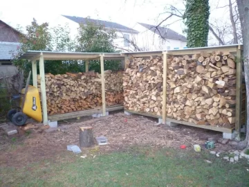

I have been collecting a lot of free wood and my wife said that we HAD to have a place to put it all! So I think that we came up with a good solution. LOL.

There will be two storage areas in the corner of my yard. Each will be 12' long X 3' deep X 6'5" tall.

Looks good!
The only bad thing about this is that you no doubt will be putting green wood in there. If you really look at it, there will be basically no air circulation that the wood needs to dry. Normally folks will dry the wood in the open air then move it to the shed before winter.
On the other hand, you have a good idea for the shed. Just needs a bit of strengthening to keep it upright. If I were you I'd leave the floor just like you have it and the ends the same. Naturally the front will be open. But that danged fence blocks a lot of air.
Good luck.
Looks pretty good, I might put a few more concrete block in the center of the long runs to spread the weight out.
Looks like the roof may sag a little? Unless there is supports that I can't see.....
Those are 4x4 with a span of less than 6' unsupported . I doubt it would be necessary, but I could be wrong, wouldn't hurt though.
OTOH, I don't have much experience with green wood. Have only stacked seasoned. Checking the weight of wet wood, it's a lot heavier, so you're prolly right about the additional blocks, especially if that thing gets filled up.

Firewood will be covered & off the ground.! Nice
Some pictures of it full of wood will make it look even better :)
Some space between the 2 rows will allow some air circulation & help in dry ;)

Looks good, but the roof does look like it needs more support. I'm trying to do the same....scrounging for wood scraps that are usable is about as easy as scrounging for seasoned firewood that is 3 years seasoned, and cut to length
What is the roof? Looks like composite or 5/4 pt. A year of snow load in my area, I think will bow the roof.
The roof is two ribbed steel panels. It seems sturdy but I will add front and back support. There will be 3 to 6" in between the stacks for drying. I'm trying to cut my wood at 15.5" for east west or north south in the T5. I will take another pic when its full, unless it falls over :-)
The roof is two ribbed steel panels. It seems sturdy but I will add front and back support. There will be 3 to 6" in between the stacks for drying. I'm trying to cut my wood at 15.5" for east west or north south in the T5. I will take another pic when its full, unless it falls over :)
I would suggest a middle support also. Don't you get snow in MD?

Spacing between rows is good & being covered will keep the rain off. It'll work just fine.

The span of that metal roofing would be fine as long as you don't get any snow where you live. ;hm
The one problem I see is your roof is flat, you don't have any significant slope to the roof,,,, so when it rains what I think will likely happen is some of the rain water will flow over and around the lowest edge and run back under the metal roofing until it contacts your roof support posts and run down them.
You should be able to tell if I'm wrong the first time it rains. Please let us know.
Looks like a slight slope, maybe a couple inches, not sure if thats enought to not do what you said. I made mine a one foot slope from front to back on a 4 foot wide rack, hops its enough, we can get some heavy snowpack up here.
Should be nice and tidy looking when you are done.
Looking good. What is kinda neat is to watch the pile shrink as it dries. As tight as you have the wood up to the roof on the shed to the right - when it is done drying, you will have a gap.
Good looking setup. As Jags said, there will be shrinkage. I've measured a 6" drop on a 2yr old stack of oak in my shed.
Good luck.
That was my first thought too. Drying time is going to be way longer. The more air and sun, the better.
