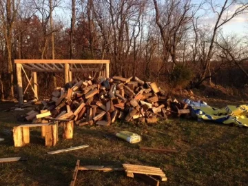

I'm building a wood shed and wondering whats the best floor. It is just dirt at the moment and thinking of laying some thick plastic on ground (6mil) then laying 3-4 inches of clean stone on top. Thinking that would let water run through the stone if any got in. Not going to build a actual wood floor and have though about pallets. Any ideas? [Hearth.com] Building a wood shed [Hearth.com] Building a wood shed [Hearth.com] Building a wood shed
Being a cheap bugger myself, I'd say go with pallets to stack the wood on, and dirt or stone where you walk. Piece of cake.
Pallets.....you can always replace them!

Pallets would be excellent, especially if there is breathing room under the your sheet metal side walls.

If gravel is free would it be good too? I got the gravel here along with plastic, I would have to find someone with the pallets.

I'd go with your idea of plastic and clean stone. Stones don't rot. I hate stepping on pallets when they break underfoot.
Even if you buy the stone it will be the most permanent part of your building. Just my 2 cents
Layer of QP stone 2-3 inches. Put down bricks in the stone (single high) and lay 2x6 PT lumber across to stack the splits on. If and when any water does get into the shed the splits will be suspended about 3 inches above the ground.
I have used pallets thus far and they work ok. Pallets need level'ish ground rock wouldn't
Plastic and stone are great and all, but the first rule of wood storage is get it off the ground. The easiest/cheapest way I've ever figured out to get wood off the ground is pallets.
I took the belt and suspenders approach. I've got a gravel floor in the woodshed and use pallets on top of that. I do the same in my separate, outdoor drying area primarily to make the pallets last longer. I think plastic is overkill. If you have the gravel you should be all set with drainage. Seem like if anything the plastic underneath the gravel might inhibit drainage.
I just leveled the ground somewhat in the shed. Once pallets in place I shimmed them a bit to be closer to level. No problem with the stacks or with any ground moisture.KISS works for me.

I am not a lover of pallets. Simply cutting some 8' or 10' saplings in the woods or using limbs to stack the wood on works very well and they are just as cheap or cheaper than pallets. After a few years they can then be cut into stove wood length to burn and then replace with more of the same.
As for the plastic/stone idea, I really do not see a need for the plastic. If water does get in there, it can soak into the ground but if you put stones there, it will already be higher than the surrounding ground so water should not be a problem.

I use drainage rock in the floor of my woodshed, it last forever, it's covered and has great drainage so it stays dry, easy to level, and no place for critters to hide and build nest under.
I will admit that you'll get a little more ventilation with something like pallets, which is important if you are drying your wood, but the wood that goes in my shed is generally dry already, so I just need to keep it that way.
