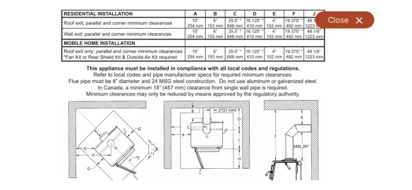

I’m building my hearth in the corner and have the base all done, I was doing research for the walls and saw something about a 1 inch gap.
I had planned on doing stone tile on the walls behind the stove, would I still need a 1 inch gap between the stone tile and the wall or is that for certain types of installs. I had no idea about the 1 inch gap when planning it. These are my stoves clearances for reference

The air gap reduces clearance to combustibles. Do you need (or want to) reduce the standard clearance? Are you installing single or double wall insulated pipe?
Looks like a BK king so double wall insulated pipe should be used. I would install to me meet regular clearances and not used the air gap to reduce clearance if possible.

Ok thanks, I wasn’t trying to reduce anything I was just worried the air gap was something that was necessary.
