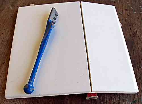

Ceramic tile tools - A simple glass cutter will cut many tiles.
At the most basic, the simplest way to cut a ceramic tile is by scoring the glazed face of a tile with a glass cutter. Using a straight edge or a square held firmly on the tile, a straight scratch mark or score is made on the surface.
A small piece of material is placed under the score, and hand pressure is applied the either side of the tile. If the score was done correctly then the tile will snap along the score mark.
A tip when using glass cutters, for glass or ceramic, have a small container of kerosene or other such light oil, and dip the tip of cutter into it every few cuts. This seems to make for better cuts. Either by just cleaning it of lubrication, I don't really know, but it works.
[Hearth.com] Building my Hearth Pad
Ceramic tile tools - A tile cut with a cheap glass cutter.
In the image above I placed a carpenter's pencil under the the tile.
Say I wanted to cut only 20mm off the edge of the tile. I would score the surface with the cutter, and then hold the tile down firmly with with my left hand with the bit to be cut off overhanging the edge of my bench. With my right hand I would snap the tile at the mark with a pair of nips or pliers.
If you look at the glass cutter, the notches in the side of it are for doing the same thing with different thicknesses of glass.
As the piece to be cut off gets smaller, I take smaller bites out of it with the nips.
It is quite possible to do small tiling jobs with no other tool for cutting the tiles. Typical splash back jobs only have a few cuts.
