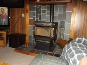

You can set it on any non-combustible surface.
Stone, cement board, slate, Or a premade pad
There is basically no heat on the underside of most if not all Pellet stoves
My stove sits on 3/4 in plywood with slate glued to it
