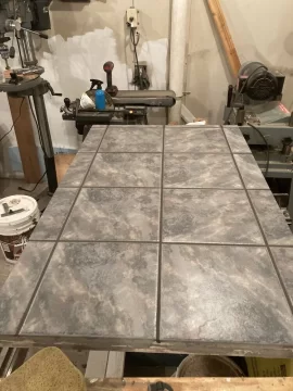

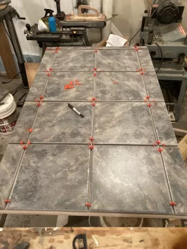

So I decided to make it 50x31. I got the plywood and the wood for the trim, sandwiched the Micore 300 between the plywood and the 1/4” hardiebacker cement board, then proceeded to cut the tiles. Not accounting for the 3/4” of grout on my diagram. So now I have to rent or buy a tile saw, because I have to remove 3/4 of an inch from the edge tiles. Like my dad used to say, “Measure twice, cut once, measure again in disbelief.” Here’s what I have so far.

For greater stiffness, I strongly recommend using 1/2" cement board on top of a soft substrate like micore so that it does not dent under the concentrated weight placed at each stove leg. The additional stiffness will help reduce deflection. 1/4" cement board should only be used with a rigid surface underneath.

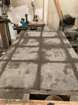

I would grout before you install timber and use caulk between the timber the tile.
The timber is more likely to shift and caulk will not crack like grout might.

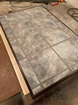

That’s what I ended up doing. Good advice on the caulk. I saw today that I can get a tube of the same color. My only remaining issue is that I blew the 90 on one of the long sides. So I either need to cut a sliver off or I need to shim it out a hair.

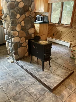

[edit] so my pipe measurements were a bit off and the stove is out in the room more than I had planned. Which means there’s a gap behind the hearth board that needs to be filled; for two inches to either side of the pipe to pass inspection. I was thinking of just throwing a couple pieces of Micore back there then a strip on top covered with a 24” strip off a 12x24” tile. I think that would get me through, and it could be removed afterwards because I think the risk would be minimal. The gap is necessary to get the required 16” in front of the stove.
