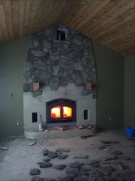

  18. ScotO
    ScotO
    Guest 2.
    Got the stone installed down to the mantel standoffs, tomorrow I'll cut and install the keystone and ledger stones across the top of the fireplace, along with the stone registers........starting to look like a fireplace!!
    I love installing the stone....

    made more progress this week, albeit slow (lots of stuff going on, busy busy BUSY!!) Anway some pics.....
    got a small fire going to help keep the room warm....
    Cut my keystone and ledger stones, and faced all of them. Yeah, it's work, but worth it in the end of the project. They really set the fireplace off!
    Filling in around the top and sides of the fireplace...
    Hoping to have all the stone (including the hearthstones which are all around 100 - 130 lbs each), grouting to come Monday evening.....
