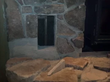

    Okay, some updated pics. Finally got all the stone hung up! Going to start the grouting this evening, hoping (amid the chaos this season brings) to finish that up by Saturday morning, then a good clean-up and POSSIBLY opening up the wall so we can use the hearth on Christmas morning!
    Stone cut and split ready to go for the registers. I had around 4 hours just cutting them bassturds .....
    Some pics of the register install...
    2012-12-17_20-16-30_543.jpg 2012-12-17_21-28-17_239.jpg 2012-12-17_22-45-11_553.jpg
    Pics of the final hearth stones. Backfilled the big stones with concrete, and veneered the concrete....

    KILLER job man, beautiful!!! I'm sure it was mentioned in there somewhere, I just flipped thru all the pics,... but where are the 3 blowers/ducts going to? Another room?
    I just finished my install, and added one duct up above the mantle, to suck in warm air, and brought the duct down to the first floor room below with an inline fan in the floor joicing. I put a speed controller in that bedroom to control the fan speed, so when the stove is burning, I can get some heat down on the first floor. Is that kinda what your doing?
    ScotO likes this.
  16. ScotO
    ScotO
    Guest 2.
    Thanks! There are three ducts (four if you count the OAK), one duct is for the blower motor, it will draw air from the kitchen and blow into the fireplace room. The other two ducts will eventually be directed through a main duct and split between the downstairs bathroom and the dining room.....I still have to fabricate that main duct, that will happen next month.
