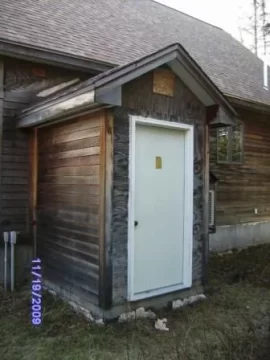

I had a new pair of bilco doors on my house when it was built and wasnt a fan from the beginning. Mice seemed to be able to walk right through them, they leaked like a seive in rainy weather, and they were a big radiant and infiltration heat loss in the winter plus they froze on occasion. I ended up building a "doghouse" over the opening with a full height door. Obviously it required messing with the siding, but my material cost was under $2,000. I also beefed up the roof and installed some heavy hooks in the ceiling to allow me to rig heavy objects in and out of the basement (like a "free" 1000 pound wood boiler) and power tools. Granted it was a project, but I havent looked back since. Just the ability to open the door and load wood in without having to shovel the snow off the doors made it worth it as my doors are on the north side of 12 12 pitch roof in northern NH so the snow tends to get real deep!

I am not having any luck with attachin a photo, PM me with a email address and I will send you a picture of the structure.

thanks for the pic
