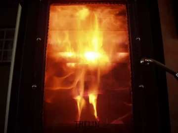

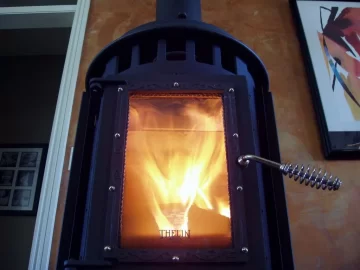

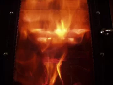

A little secondary combustion anyone? Stove top temps around 750 degrees. I know, most of you cringe at that, but this is where she maintains secondary the best. These temps are supported by the manufacturer, so I'm not too concerned. The firebox on this stove is very small, so aggressive burning is required to pre-heat for the secondary system. I think the Thelin stove is one of the more unusual stoves on the market. Comments and comparisons welcomed. If this picture post goes well, more to come. Enjoy.

DonCT said:
WOW!!!!!!! That's what I'm talking about!!!!
What type of camera did you use to cap those pictures?
Couple year old Olympus 5.0 mega pix camera. I experimented by blocking some of the camera's sensors to improve the fire resoloution. Honestly, I don't remember what combination worked best.

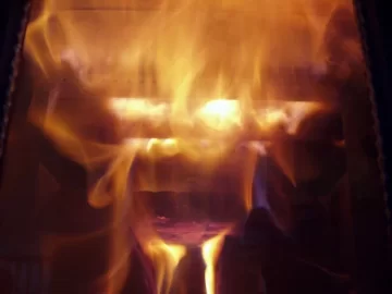

Here's one more picture for the record. Notice the fire brick at the top front of the stove to restrict air to my 20 foot straight up Class A... Doesn't look like it's doing much, even though I've probably restricted the flow by 25-35 percent.

Great looking stove and awesome pics!
Any pictures of the whole stove and how it sits in it's surroundings? From what we can see here, that's one awesome looking stove.
Yes, more pictures to come. I am traveling and the overall perspective photo's are on the home computer. I have the fire pictures to keep me warm on the plane... :-)

Exceptional shots especially on the secondary burns! I know difficult and frustrating it can be to get the "perfect shot".
