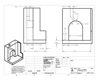

My setup right now is like this:
7" oval to 7" round for 11" exiting the top of the stove
7" to 6" reducer
6" diameter 90° (backwards)
12" horizontal of 6" diameter pipe with about 1/2" of rise over the length
6" diameter 90° (upwards)
Through 6" thimble into 7" x 7" flue tile at approximately 45°
12" at the 45° angle, then another 45° to go straight up again
About 10' of straight up 7" x 7" flue tile lined brick chimney which is between an exterior and interior wall
About 2 or 3' straight up above roof of the 7" x 7" flue tile lined brick chimney
At the top of the existing chimney I added 6' of 6" round Simpson Duravent insulated SS chimney and a cap to help satisfy the 2-3-10 rule. I would have gone with an 8" round addition on top of the chimney (which I already had and didn't need to buy) but I was afraid of junk slipping down the chimney then landing on top of the brick chimney and running down it and making a mess.

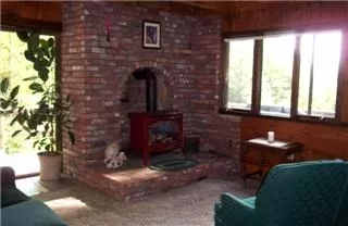

I've attached some drawings of the hearth setup (no stove or stove pipe) to clarify the beginning of the chimney with the 45° bends in it. I also attached a photo (from the real-estate ad from when I bought the place in November) of the gas stove that I pulled out, you can sort of see the two 90° bends in the stove pipe.
