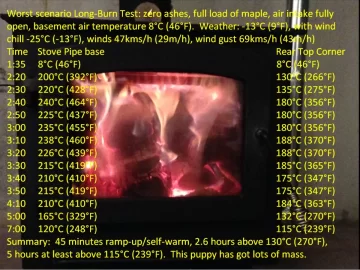

The center of my stovetop is nearly twice as hot as its right rear corner. Here is the 1st portion of the ramp up curve starting from zero ashes. Reference readings are from the very right rear corner. Un-insulated basement, bare cement walls.

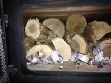

This looks amazing, how dry was your wood in this picture?
Yes, about 17%. It's 7-8 month seasoned doug fir. It dries quickly in our low-humidity summers.
