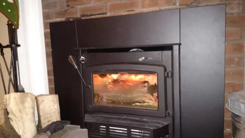

My draft appears stronger in the extreme cold. I keep my air on the lowest setting and I can see the burn is stronger and faster. So I'm going through wood much faster than when it's not as cold outside.
5 degrees outside and house is sitting at 70 degrees and 73 in the hearth room. I'd have to push the stove beyond my comfort level for wood consumption to get any warmer.
Remember to watch those pipes in the basement if unheated. Cycle the boiler or furnace to warm up the area occasionally or put an electric heater down there if necessary.
The strong draft and seasoned oak and ash climb to 425 with less than 20mins, I close the choke all the way down . The secondary is mesmerizing!
